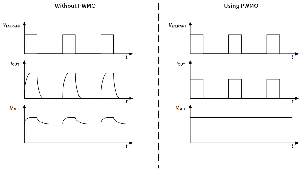

What's the difference of TLD5099EP dimming between using PWMO and opening PWMO ?
fausto_borg
Moderator 10 likes received 10 sign-ins 5 solutions authored
For an LED driver the difference is on the waveform of the output current.
Using PWMO connected to and NMOS the system is able to produce very sharp current waveform at output, while if the PWMO is left open the the current waveform is prolonged even after the PWM signal goes to low level.
The reason is that without the dimming element the output current is not interrupted by the PWM modulation and it flows into the load until the output voltage of the DC-DC is higher than the forward voltage of the LED string.
This means that with a dimming element the system is able to replicate at output also very low duty cycle PWM modulation that are not possible without (the system has to recharge the output voltage to have the desired output current).

Here in the below picture I also highlight the main difference on the produced waveforms of output current and voltage.
4943.attach
As reported in the previous reply, the main advantage using the PWMO dimming device is the sharp waveform of the current.
You can also look that the output voltage stays constant, because the dimming element prevent the discharge of the output capacitor on the LED string.

Thanks for your detailed explanation,that helps a lot. sometimes leave the PWMO open just for the cost-down.
