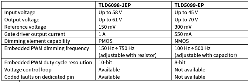

As we know, TLD6098-1 Vin up to 58V,and TLD5099ep is 45V, Are there any other differences besides that?
And another question:
TLD6098 used PMOS,TLD5099 used NMOS,Is there any difference?

TLD6098-1EP differs from TLD5099EP for the following key points:
4944.attach
Please check frequently our LITIX Power webpage and LITIX Power Flex webpage to have more information on the new products.
