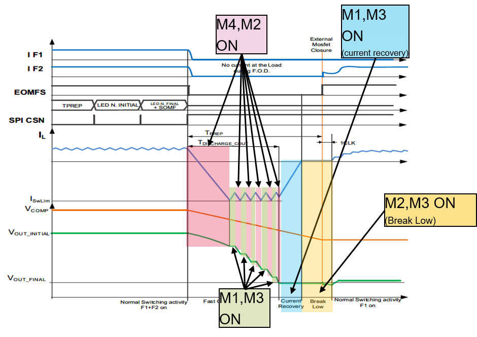

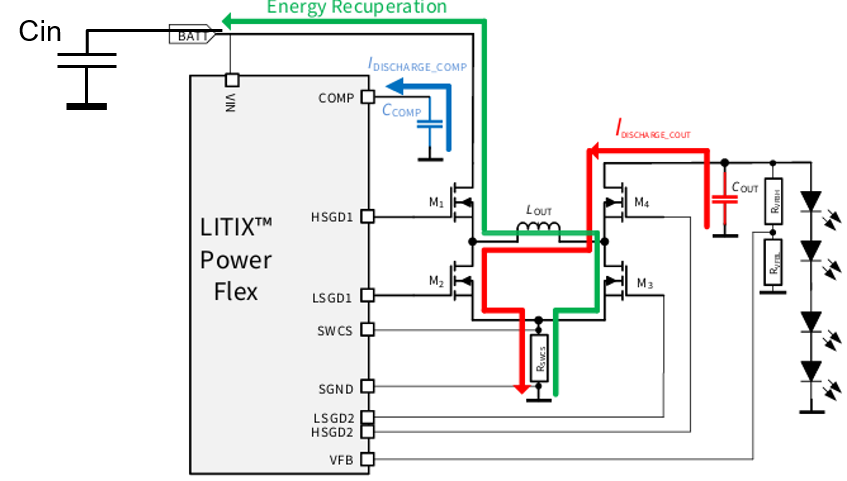

The TLD5542-1QV has a fast discharge feature that allows to quickly discharge the output capacitor. During a fast discharge phase the ouput capacitor is getting discharged to the input capacitor and therefore causing a small reverse input current.
.4784.attach
The figure below shows the switching pattern and waveforms during this fast discharge phase.

Read more on fast discharge in the datasheet on pages 27 and 28.
