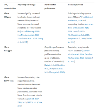

  2. Are scientific literature available indicating the harmful effects of CO2 for human body?
    Several studies have been done on the effect of CO2 on the human body at various concentration levels. The summary is provided in the chart. See Source [1] for the details of the study.
    Figure 3. Impact of CO2 on the human body at various concentration levels

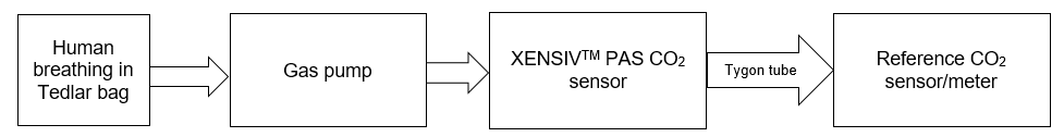

  3. How can I generate a known level of CO2 in ppm?
    CO2 sources are numerous such as bike tire CO2 inflators, soda water, and human breath. To arrive at a known level, capture the CO2 gas in a Tedlar bag and pump it into a gas chamber using a 6-V diaphragm pump. CO2 concentration can easily reach more than 10000 ppm in such a setup. A reference CO2 sensor can be used to measure the known level. See the application note, Recommended performance evaluation methodology for XENSIV™ PAS CO2 sensor.
    One such setup is as follows:
