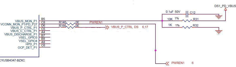

Convert the DS1 PD port into Type-C port
  1. Connect CC1 of DS1 Type-C connector to pin D8 of HX3PD. Similarly, connect CC2 of the Type-C connector to pin C7 of HX3PD.
  2. For the DS1 port:
    a)  Connect a potential divider circuit between VBUS_MON_P1 (B5 pin) and US_VBUS. Based on VBUS from the Type-C connector, CCG4 will enable VBUS to turn ON the hub.
  3. Connect VBUS_P_CTRL_P1 (pin D6) to enable the pin of the power DS1 switch.
  4. Connect VCONN_MON_P1 (pin C8) to the hub pin PWREN_P1 (pin J6).
  5. Connect OCP_DET_P1 (C6 pin) to the power switch’s overcurrent detection pin. Ensure that it goes to OVCUR_P1 (pin K6) of the hub.
  6. Connect the I2C lines of the hub controller (I2C_SCL_HUB and I2C_SDA_HUB; pins M5 and G10) to the I2C lines of the DMC (I2C_SCL1 and I2C_SDA1; pins E11 and D11). See Figure 4.
    Figure 5 HX3PD DS1 port connections
    Figure 6  DS1 power switch connection
    Figure 7  VCONN_MON pin connection to hub PWREN
    Figure 8  CC lines from DS1 Type-C connector to HX3PD
