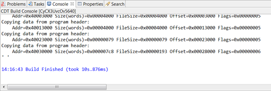

11. Save and build the project. EZ-USB SDK should generate an image file. If the build, generation of the image file, or both fail, check the console output message to locate the root cause.
