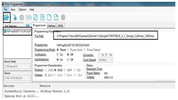

  2. Program and update the Bluetooth Low Energy (BLE) dongle firmware. You can find the hex file here: C:\Program Files (x86)\Cypress\CySmart\1.2\dongle
  3. Open the latest version of PSoC® Programmer, which can be downloaded from here: PSoC Programming Solutions
  4. Connect the BLE dongle to the USB port of your computer.
  5. In PSoC Programmer, select the dongle. Click the Folder icon to select the hex file of the dongle.
  6. Click the Program icon. After programming, the status will be PASS.
    Figure 1: Selecting Dongle Firmware to Program

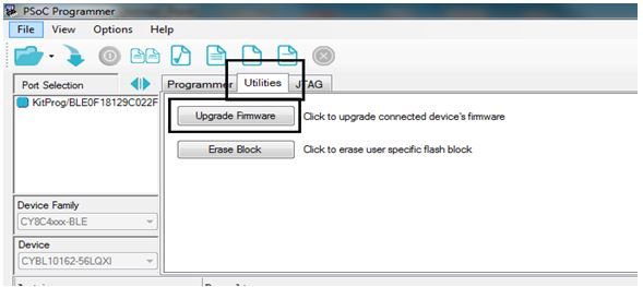

  7. Go to the Utilities tab. Click Upgrade Firmware.
    Figure 2: Upgrading Firmware Selection
