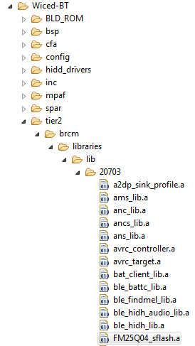

  6. Navigate to CYBT_353027_EVAL_PLATFORM_FILES\Wiced-BT\tier2\brcm\libraries\lib\20703, then copy FM25Q04_sflash.a.
  7. Paste and replace FM25Q04_sflash.a file in WICED-Studio-6.2\20706-A2_Bluetooth\Wiced-BT\tier2\brcm\libraries\lib\20703\ as shown in Figure 2.
    Figure 2

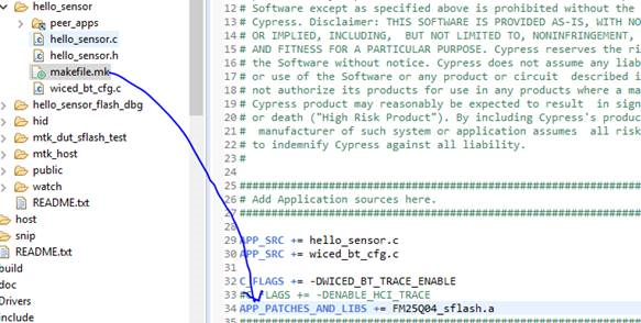

  8. Include FM25Q04_sflash.a in the makefile.mk of the user’s application project. Figure 3 shows an example for the hello_sensor application project. FM25Q04_sflash.a must be included in the makefile if application firmware performs NVRAM write or read operations (a serial flash device (NVRAM) is available in the CYBT-353027-01 module).
        Figure 3. APP_PATCHES_AND_LIBS += FM25Q04_sflash.a
A sample make target to build a project in WICED Studio 6.2 for this CYBT-353027 evaluation kit is as follows:
demo.hello_sensor-CYBT_353027_EVAL download
