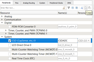

  6. Redo the configuration needed by the application. In some cases, you can copy-paste the personality settings from the design(1.x).modus file:
    1. Open another instance of the Device Configurator and open the design(1.x).modus file.
    2. Navigate to devicesupport.xml file as done in Step 5.
    3. Highlight the peripheral and click Copy.
    4. Open the other Device Configurator window and paste the settings into the corresponding peripheral.
      You may need to re-configure pins, clock trees, and any other resources needed for the peripheral.
