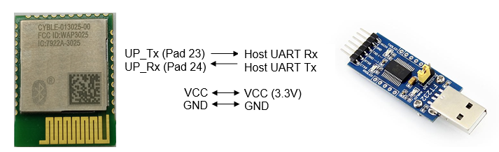

The HCI-UART interface available on the CYBLE-013025-00 does not support hardware flow control, so only the HCI-UART Tx/Rx signals need to be connected to allow for programming of the module.  Ensure that the HCI-UART Tx/Rx signal connections are accessible during the programming step (access can be on the host board, or as part of a customer developed manufacturing programmer). The programming steps will differ depending on use-case (evaluation kit versus module only).
I. To program a stand-alone CYBLE-013025-00 module on a host board
  1. A USB-to-UART bridge, such as the FT232 (shown in Figure 1), can be used for USB-to-UART conversion.
  2. Connect the module’s VCC/GND/UP_Tx/UP_Rx connections to the VCC/GND/Rx/Tx connections on the USB-to-UART bridge
  3. Ensure that the VCC voltage of the USB-to-UART bridge is 3.3V.
  4. Assert UP_RX to HIGH and then power on or reset the module. This process will put the module into HCI mode and ready for programming.
Picture1.pngFigure 1. Connection between CYBLE-013025-00 and FT232
Tips: The Tx signal on most USB-to-UART bridges is HIGH after power-on. Power cycling (OFF then ON) the USB-to-UART bridge can put the module into HCI mode if the default Tx signal level is HIGH on initial power up.
