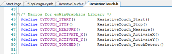

Note the.c/.h files being generated for the Component in the GeneratedSource directory.  The ResistiveTouch.h file contains emWin library-specific macros as shown in Figure 3.
Figure 3. Resistive Touch emWin Macros
