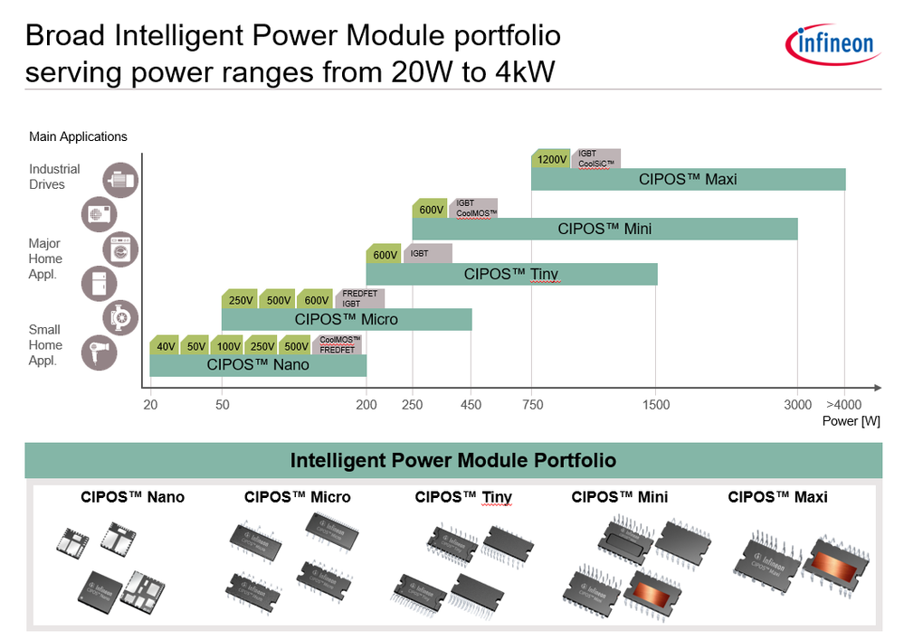

Dears,
while checking out the Infineon website i was trying to find the best matching IPM for my configuration.
Do you have a hint how or where to find the best suited device?
Thanks in advance.

Hello!
There are a couple different methods to figuring out which IPM will work with your application. The method you choose depends on how much information you know about your design...
If you are just starting out with your design and only know your approximate power and target application then I would recommend using the product table on the IPM webpage to filter out parts that would work with your desired power and voltage. You can also check out the IPM selection guide which details the product portfolio and main applications but please note this document only gets updated about once a year so sometimes the newest products may not be included. I also included an image that shows the IPM product families along with their power range and target applications which may help 🙂
This gives a general idea of which product family to choose but you may need more information about the design to narrow down which IPM works best.
If you are farther into the design process and know your motor parameters as well as the thermal environment, then the IPM Simulation Tool will be extremely useful in helping you select the best fitting IPM. This tool estimates the power losses and temperatures of the IGBTs/MOSFETs within the IPM using your motor drive parameters (DC voltage, power factor, system freq, output voltage and current, etc.). To know how to use the tool, please watch the video tutorial on the tool's webpage. There is also a user manual that goes into more detail.
