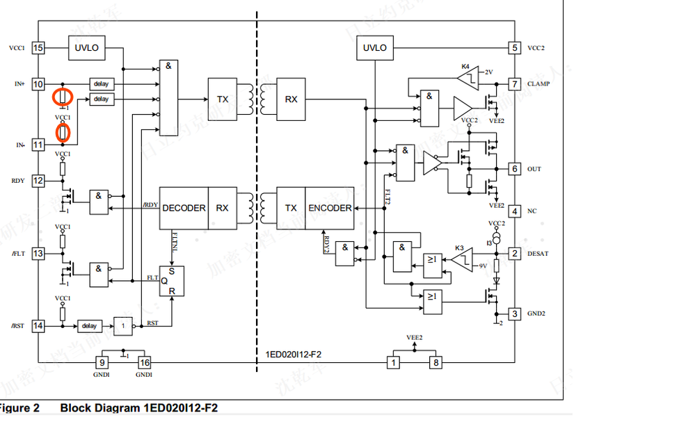

Dear Community,
Regarding of 1ED020I12-F2,
What are the two resistance values in the red area of attached file?

Hello Yoshimura,
The pull-up and pull-down resistor values can be calculated using the information provided in the datasheet.
Please refer to chapters 2.2 and 2.6 of the following app note:
https://www.infineon.com/dgdl/Infineon-EiceDRIVER_1EDfamily_Technical_description-ApplicationNotes-v...
Here, it is explained that Rd and Rp can be calculated as:
Rd = VCC1(typ)/In+(typ)
Rp = VCC1(typ)/In-(typ)
You can find the data in table 3 and table 6.
Therefore: Rd = 5/100μ = 50kΩ
Rp = 5/100μ = 50kΩ
I hope my explanation helped.
Pablo
