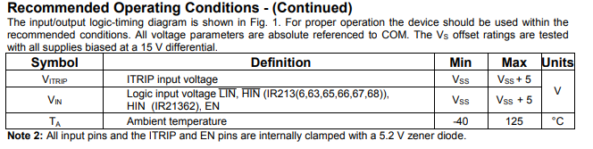

I have made a 36V 250W BLDC driver using the IR2136 controlled by a dspic33FJ. I have 10 of these designs running in the field with mostly success... Somehow there is a situation the driver doesn't work anymore. If i replace the IR2136 on the board everything works as expected...
The PWM signals are 3.3V and i have te EN input also connected to the dsPic digital output 3.3V.
Meanwhile i found the following in the datasheet for the EN input:
Do i need to operate this EN input as 5V to work properly?
5198.attach
Can anyone please confirm me if this is the case or 3.3v on EN input is fine?

The IR2136 will work with either 3.3 V or 5 V input for enable pin. See page 3 for the specifications as below:
5200.attach
5201.attach
On the failure, is it the driver only that is failing or other components also fail? Is any particular section of the driver failing like VCC to VSS short or HO / LO shorted etc.? After replacing the drivers, is the failure seen again on the same boards?

Hi Srivatsa,
Thanks for your reply and confirmation about the control voltages.
I just received again a broken board with the same complain. everything works except the BLDC motor doesn't run anymore.
1. Main Power supply is 40V from 36V Lithium Ion.
2. Vcc is 16V. Powered from a LM2576HV.
3. Enable signal is 3.3V.
4. There is no short between VCC to VSS.
5. There is no HO/LO shorted.
I will replace the IR2136 and check if everything is functional again.
If any suggestions to tackle this problem please let me knw.
Many thanks for helping!
