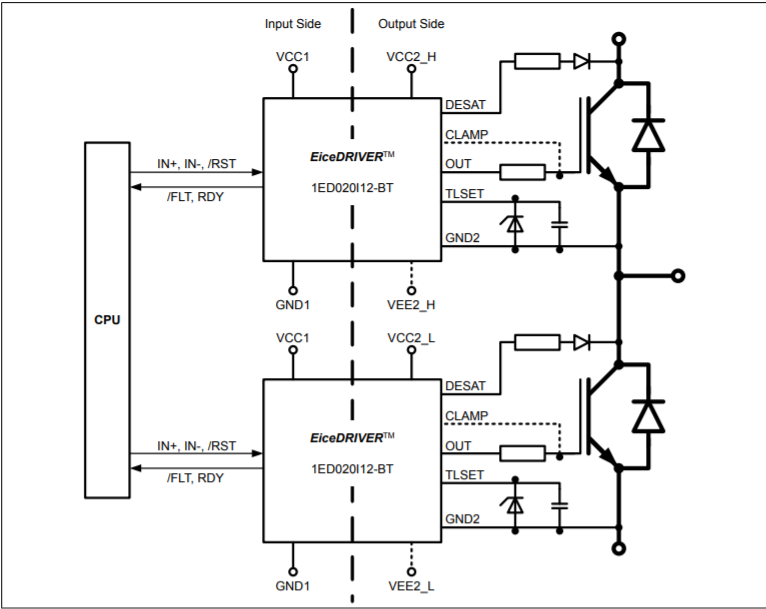

Can you please explain the routing done on the PCB for the gate driver IC. This would help us further shortlist the gate driver IC.
As per the connections seen in the image, there is a capacitor and diode connected across pins 1 and 2. But from the 1ED020I12-BT datasheet application diagram as shown below, this connection has to be made across TLSET and GND2, which are on the pins 4 and 3. So please take care of these external IC pin connections.
5239.attach
As far as the farnell parts are considered, please use the below item number,
https://dk.farnell.com/infineon/1ed020i12btxuma1/igbt-driver-40-to-105deg-c/dp/3234276RL?st=1ed020i1...

It is mysterious, as if i follow pin 4 (TLSET) from the datasheet from -BT and pin 3 (GND2) this tracks end on the back side of the PCB to no components, but it is prepare for components, as you can see on the picture.
It is mysterious there is no datasheet of the -FF version.
