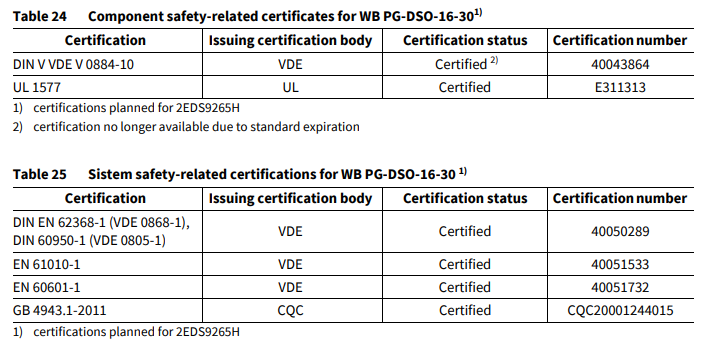

You can see the certifications your gate driver model has under the "certificates" tab on the product's page.
For example, for 2EDS8265H : https://www.infineon.com/cms/en/product/power/gate-driver-ics/2eds8265h/#!documents
In addition, the datasheet shows which certifications the product has passed if any.
Below is the example for 2EDS8265H.
5380.attach
Usually, only reinforced isolation drivers go through the certification process.
If the model you are considering does not have a certification, the "certifications" tab in the product page as well as the certification-related tables in the datasheet will not be available.
