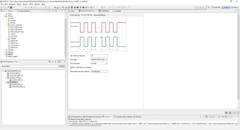

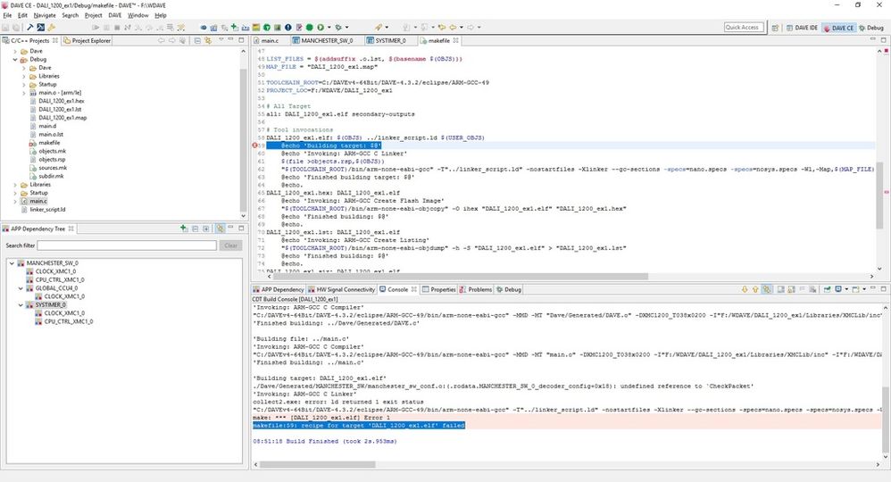

When compiling the generated code, DAVE issues a compilation error: makefile: 59: recipe for target 'DALI_1200_ex1.elf' failed. How to fix it?

From the error message it seems you are missing an implementation for the function CheckPacket().
