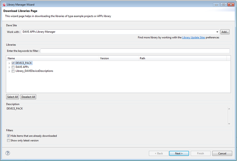

I can't creat any of the Dave Projects in my virtual Maschine (vmware ). It's a Windows 7 64 bit System.
The Problem is that I can insert like in the screenshot.
the button "next" is schwitching from gray to a black text (the button is enabled)
I can press the button and nothing is Happening.
I don't get the next page "Microcontroller Selection Page"
I get this page only on my pc ouside of the virtual machine. I installed the same Dave Version on my normal pc.
I'm using all the time my virtual machine to develop my stuff
hopefully somebody can give me an Fastback.
Only in my virtual machine I'm using my svn system
thanks a lot

Hi Thomas,
The problem seems to be related to your DAVE project workspace. It happens when launching old workspace (that is created using older version of DAVE) inside new DAVE v4.1.2. From the image, I could see that you are using DAVE v4.1.2.
Can you please try to start a new workspace in DAVE. It should work.

thanks for your help.
the problem wasn't the Kaspersky for this issue.
It was related to no device lib.
I installed the device lib and now I can work correctly.
the questions is only why the installation in my virtual machine was without device lib and on my normal pc with device lib.
It was installed with the same setup routine file

I experienced the same issue with Xubuntu Linux 15.10 + Virtualbox 5.0.8 + Windows 7 64bit + Dave 4.1.4 and never touched Kaspersky.
The solution to this problem was to install the missing device lib - thanks!
BTW, while clicking on the mentioned "Next" button (first post) when trying to launch a project, this error can be observed:
A reason for the missing lib(s) could be that the VM might not have had Internet access during the installation. However I am not sure about that and could not reproduce the problem.
