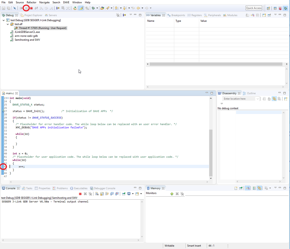

Hello
I have "PEmicro Multilink Universal" programmer
I have followed the steps to integrate PEmicro plugin into DAVE
I am stucked at "Select Device" in Debuggin tab; where the list is empty, I can not select anything
See picture.
See picture.
