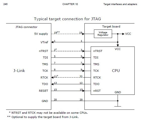

Hi all,
can someone help me how to use external j-link....?
I want use J-Link EDU from SEGGER: http://www.segger.com/j-link-edu.html to debug MCU in relax kit.
I have connected "Cortex Debug" pins according to manual: 89.attach
connection:
nTRST: I did not use
TDI: I used pin 8 at X5 (cortex debug - on relax kit board)
TMS: I used pin 2 at X5 (cortex debug - on relax kit board)
TCK: I used pin 4 at X5 (cortex debug - on relax kit board)
RTCK: I did not use
TDO: I used pin 6 at X5 (cortex debug - on relax kit board)
nRST: I used pin 10 at X5 (cortex debug - on relax kit board)
But I had problem with connection...

Hi Koumak,
the JTAG Interface of the XMC4000 must be enabled by pulling up the TRST# pin of the XMC4000 with a resistor. After a system reset P0.8 is working asTRST# with a
weak pull-down active. So, tie pin 24 (P0.8=TRST#) of pin header X2 to pin 38 (VDD3.3)
Does this help?
