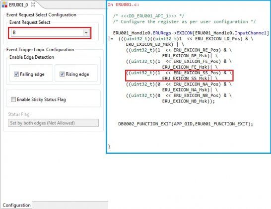

Hi pitupitu,
Did you change "Event Request Select Configuration" from "A" to "B" in ERU001 configuration tab?
Zain
Zain

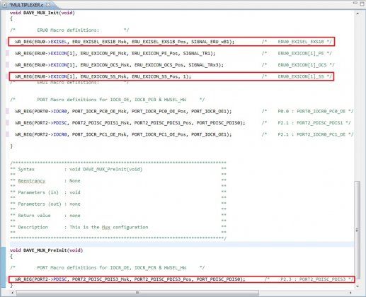

Hi pt,
Configure "Event Request Select" to "B" in ERU001 configuration tab is equivalent to "ERU0_EXICONx.SS=1". Do remember to click "Generate Code" button after changing the UI setting.
Another option is to put all the changes in MULTIPLEXER.c
Zain
