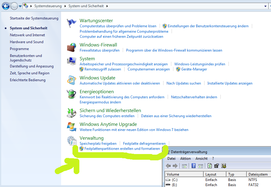

3. Optional: Format the new virtual HDD in Windows
similar to this tutorial: http://www.wikihow.com/Partition-Your-Hard-Drive-in-Windows-7
