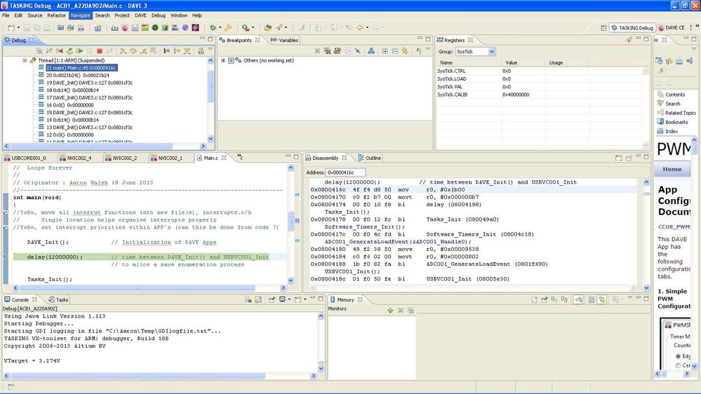

I had a working project which included 4 x NVIC002 and 1 x SYSTM001 Apps.
I changed the interrupt priorities of them to 63, 62,61,60 and 10 respectively.
After this I found the SYSTM001 no longer runs.

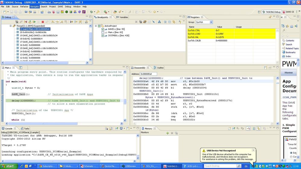

Here are the SysTick settings after DAVE_Init() is called on a working project....
Here are the SysTick settings after DAVE_Init() is called on the broken project, SysTick has not been initialised.

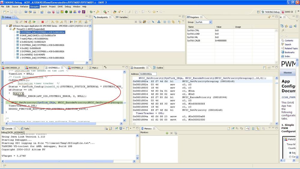

DAVE_Init() calls SYSTM001_Init() and I found that the SysTick_Config() function shown below returns a Status value of 1 instead of 0.
Strangely, the 'if(Status == 1U)' code does NOT detect the 1 and the code jumps over the 'DBG002_ERROR(APP_GID,SYSTM001_ERROR, 0, NULL)' statement, so no error is reported.
I have reset all priorities back to the default of 63, re-generated code, cleaned the project and rebuilt all but I cannot get SysTick initialised.
I would really appreciate any advice on this and possible fixes without having to re-create the block diagram again.
