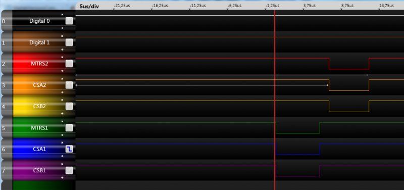

I tried to change the CS of 2 SPI001 Controlls. Basically it works but I get the Problem that when I change the CS with the following commands both CS go to zero at the same time for a moment. (Including MTRS)
Is there anything I'm doing wrong? This behavior is very evil for may SPI devices.
SPI001_Handle0.Config->CESelected = CE_B;
SPI001_Configure(&SPI001_Handle0,SPI001_Handle0.Config);
SPI001_Handle1.Config->CESelected = CE_B;
SPI001_Configure(&SPI001_Handle1,SPI001_Handle0.Config);

A quick Solution for me was to config the PCR register in a separat function. Hope it helps somebody out.
So there is only one question. Since Dave/XMC4500 supports multislave SPI out of the box what is the way dave developers will change CS?

void xmc4500_switch_cs(const SPI001_HandleType* Handle, uint8_t CESelected)
USIC_CH_TypeDef* USICRegs = Handle->USICRegs;
USICRegs->PCR_SSCMode &= (~(uint32_t)(USIC_CH_PCR_SSCMode_SELO_Msk));
USICRegs->PCR_SSCMode |= (((((uint32_t)0x01 << Handle->ChipSelTable[CESelected]) << USIC_CH_PCR_SSCMode_SELO_Pos) & USIC_CH_PCR_SSCMode_SELO_Msk));
Michael

Hi Michael,
Thank you very much for the feedback. This is a known issue and will be fixed in the future release (eTicket 241497566).
Sophia

It has been fixed in DAVE v4 already. Would you pls try SPI_MASTER App in DAVE v4?

You can use the workaround provided in eTicket 241497566 which uses SPI001_Configure () API with input "SPIConfig.CESelected" to change the chip select.
BTW, you can find the corresponding ChipSelect pin from Resource Mapping Reports (by clicking "Resource Mapping Information" button in the tool bar). The port pin configuration can be found in MULTIPLEXER.c DAVE_MUX_Init().
