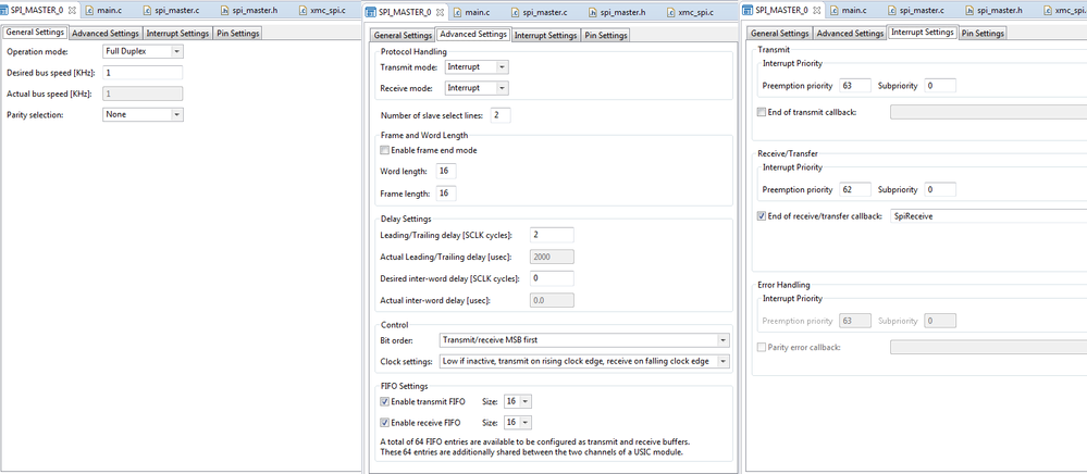

I am building a current sensing appliance. I am using XMC4500 application processor and TLI4970 current sensor. How should I set up the SPI Master App on XMC4500? I've already played around with it but I get no sensible data from the TLI4970.
I attached spi master app config:
1918.attach
I am using this code:

The receive interrupt fires, but the returned value is always 65535.

It was actually a hardware problem - isolators for a second SPI Device on the bus that destroyed the signals.

- Don't use Disable/EnableSlaveSelectSignal, it's not needed
- Make sure you only have one slave select signal configured in the app, it doesn't work if there's more than one configured
- Enable frame end mode and set word length and frame length to 16
- Set Leading/Trailing delay to 2
The TLI component samples from the hall sensor when Slave Select is pulled low and needs the leading delay so it can prepare the SPI message. And Slave Select needs to go high after every message, this is accomplished by frame end mode.
