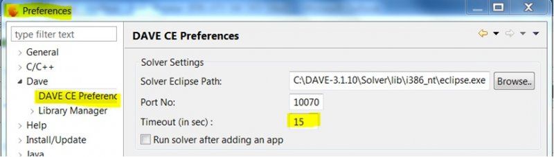

In deed, DAVE used to support and test for Windows XP including DAVE 3.1.10.
However, due to support stop from Microsoft and Oracle, DAVE will not be tested in windows XP any more. We do recommend you to upgrade the OS.
The reason for the manual pin assignment problem is OS performace related. We suggest to increase the solver timeout to eg. 30/45/60 secs and see whether it helps.

Hi Sophia,
thanks for your answer, but your recommendation doesn't change behavior.
On XP all graphic entry masks execute mouse commands without problems except 'Manual Pin Assignment' and 'Manual Resource Assignment'. It looks like mouse events (clicks) are catched by wrong graphic component. I suppose the entry masks of 'Manual Pin Assignment' and 'Manual Resource Assignment' base on a different graphic toolbox (SWING,SWT...) than the rest of DAVE, otherwise all masks should show the same wrong behavior.
DAVE 3.1.10 runs perfect on XP except mentioned two masks.
DAVE 3.1.8 had the same bug on XP.
