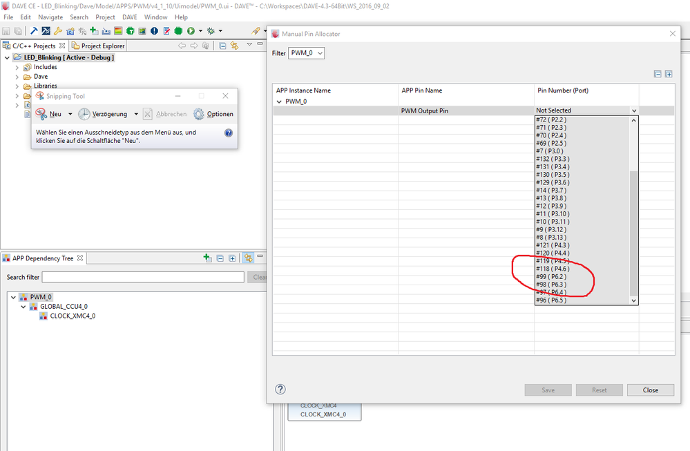

Hello everyone,
My board is Infineon XMC4700 Relax Kit using XMC4700-F144k2048 microcontroller. I want to blink LED1 by using a PWM signal. The pin number of LED1 is P5.9 according to the user manual.
However, as shown below, this pin number is not availible in the list.
Could you please tell me what I should do to solve this problem?

In the PWM APP select CCU8 as timer module. CCU4 timers has no connection to P5_9.

I could assign P5.9 by using CCU8.
I have similar question for P5.8 I am unable to do it either by using CCU4 or CCU8.
