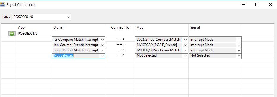

I am working with xmc4500 relax kit and having a problems with POSIF interrupts. I want to track the positions so i am using POSQE001 App. I want to have two interrupts at position counter compare match and position counter period match. These two interrupts are mapped to my own functions with two NVIC002 apps. I am only able to get period match interrupt only in one direction. Compare match interrupt does not occur no matter what i do. Also in order to get period match interrupt, i have to check the option in POSQE001 App GUI setting panel (Enable Position counter overflow event) in addition to manually enabling the event in main function with the following code. if i do not check it this, then period match interrupt also does not occur.
I dont know why i need to enable the GUI option, when i am enabling the events manually. but the problem does not end here this period match interrupt only occurs in one direction of movement but not in the other direction e.g it occurs only in Clockwise direction, but not in anti- clockwise direction. it should occur in both directions.
could anyone please explain what the option in POSQE001 App GUI setting panel (enable Position counter overflow event) means, what does it do, why is it necessary. and is it necessary to check if i am enabling the events manually. because if i do not check it and enable the events manually then both interrupts does not work.
secondly and most Importantly, please someone help me how to get compare match interrupt and period match interrupt working in both directions. I am also enabling the events manually and setting CompareMatch and PeriodMatch values with the following code in main function, but nothing is helping.
and also one more question when does Position counter Event 0,1 and 2 interrupts occur? what are Position counter Event 0,1 and 2?

I think the issue is regarding signal connection and enabling the correct events in clockwise and anti-clockwise direction.
Please find detailed explanation below:
Explanation about the events used in APP:
Position counter Event 0: External count mode (quadrature clock of POSIF is connected to CCU4 slice event 0)
Position counter Event 1: External direction (direction signal of POSIF connected to CCU4 slice event 1)
Position counter Event 2: not used
GUI option to enable position counter overflow:
GUI option enables the CCU4 period match event in the code. It is same as enabling event manually in main code.
Interrupts:

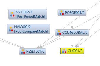

signal connection with NVIC002 APP is required which assigns the correct SR number to particular event. I think user is not doing this signal connection (period match event to NVIC002/0 and compare match event to NVIC002/1).
In anti-clockwise direction, user will get one match event instead of one match event.
This can be enabled manually as
POSQE001_EnableEvent((POSQE001_HandleType*)&POSQE001_Handle0,
POSQE001_POSITION_COUNTER,
1U);
Regarding compare match, he has already enabled both up and down compare match. I believe if signal connection is correct, he should get this interrupt.

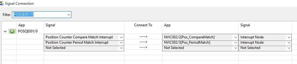

hi
thanks for a quick replay. but i am already doing signal connection and did not mention in my question the first time. i am sending you screenshots. i am using NVIC002 APP in other peripheral interrupts too e.g in usart, there its not a probelm and it works fine. secondly, before posting the question here, i have already tried setting the period match and compare match before starting the app too. it also did not work please find the pictures of the connection signals below.
also about the GUI option if i try to uncheck it and then enable event manually then no interrupt occur although as you mention they both are the same. dont know whats happening.:rolleyes:
and one more question does one match also trigger period match interrupt because in signal connection drop down there is no one match interrupt option to write ISR.
please help.

in signal drop down there is no option to make connection for position counter one compare event. In POSQE app the default is center aligned counter mode so this option should be there.
But, with the hit and trial method i found that in one compare match event, the period match ISR is called. but i dont know how to call a separate ISR for one compare in POSQE app. when there is no option to make a connection to NVIC002 app. that is my question, i hope this explanation helps.
Best Regards 🙂

Regarding signal connection, one match event signal and period match event signal are using the same signal. Similarly, compare up match and compare down match signals are same signal.
You can get the control in the same ISR depending upon the direction of counting. The only thing that needs to done is to enable the event (one match and compare down) in INTE register.
