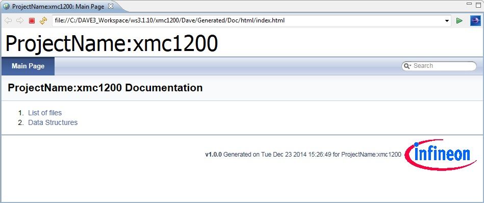

Hi zbyno,
The "Generate Doc" option is used to generate the doxygen formatted documentation for selected DAVE™ App/s in the project
Go to: >DAVE>Select "Generate Doc"
The "View Generate Doc" option provides the facility to view generated doxygen documentation in Html format.
Go to: >DAVE>Select "View Generated Doc"
You need to "Generate Doc" 1st in order to "View Generated Doc". Attached is an example of cover page of generated document.
1057.attach

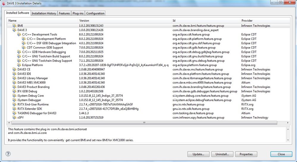

Hi zbyno,
After selecting "Help>Check for Updates", you should get message "No updates were found" if you are using the latest versions.
I'm afraid that your DAVE 3.1.10 was not properly installed. Pls try to un-install then re-install DAVE 3.1.10 and see whether it helps.
Attached is the DAVE 3.1.10 Installation Details for your reference.
1060.attach
Sophia
