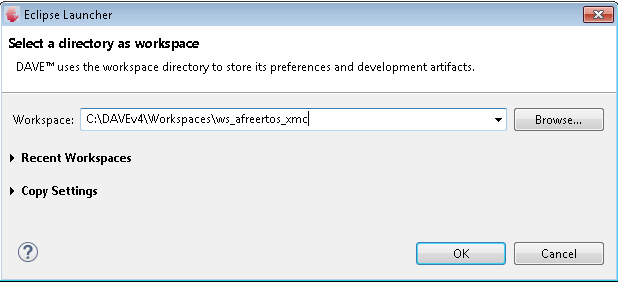

and then an Eclipse Launcher pop-up window will appear.
Click OK.

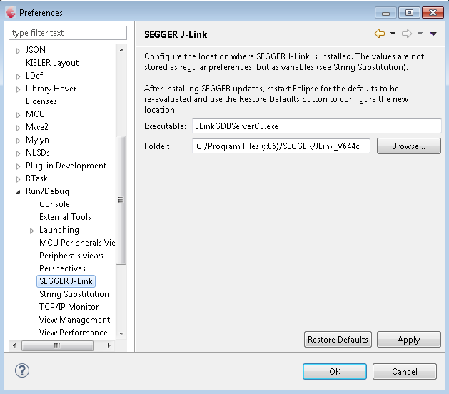

It is always recommended to keep updated the JLink software.
After installation of a new JLink software package, check and update the Segger JLink preferences in DAVE4.
