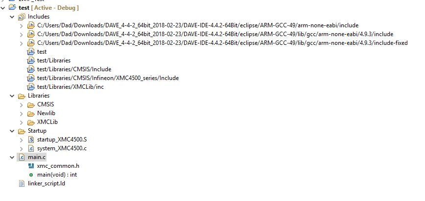

I did what you did and it compiles OK. take a look at your project and make sure it has all the includes at the right path. Attached is a picture of my project window.
You might have to uninstall and reinstall if you don't have those include paths.

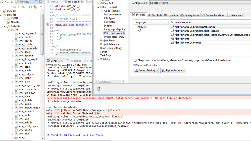

now i found the file i missed. It was there but the IDE didn’t find it via pressing the F3 button. And i could not find it because i am unfamiliar with this windows and powershell seems not to include find. Sorry.
I managed to alter some failing include statements by adding relative path to the filename. But i'm stuck at xmc_scu.h including xmc_common.h. I tried several variants but neither works.
I don’t know what messed with the include search path. Is there a way to set/fix this in the project settings? A short look at it didn’t reveal any flaws obvious to me. I don’t think that it is meant to be fixed in every single include statement throughout the compilers internal settings. A lot of the files whose path i could fix were found by the IDE but the compiler refused to use it without specifying a path.
By the way, is it supposed correct behaviour to tell ›Build Finished‹ at the bottom line when the build failed because of an fatal error. This fatal error has to be searched for throughout the output. And the error line turns red only if you click at it.
