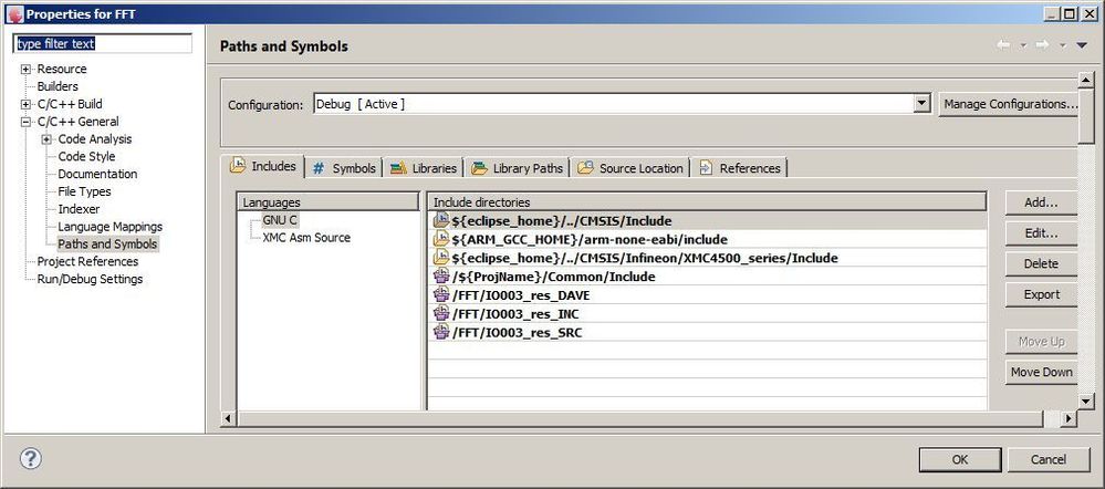

Good day,
It shall be a silly question:
I want use IO003_TogglePort function from IO003_Example1, in different DAVE project.
How it can be done best way?
BR
K

Good day,
I add linked resources, and paths, compilation is done without errors,
but it is still not working...
BR
K

Adding initialization lines from parent project:
WR_REG(PORT3->IOCR8, PORT_IOCR_PC1_PO_Msk, PORT_IOCR_PC1_PO_Pos,0);
WR_REG(PORT3->IOCR8, PORT_IOCR_PC1_OE_Msk, PORT_IOCR_PC1_OE_Pos, PORT_IOCR_OE1);
just before call:
IO003_TogglePort(IO003_Handle0,1);
solve problem.
