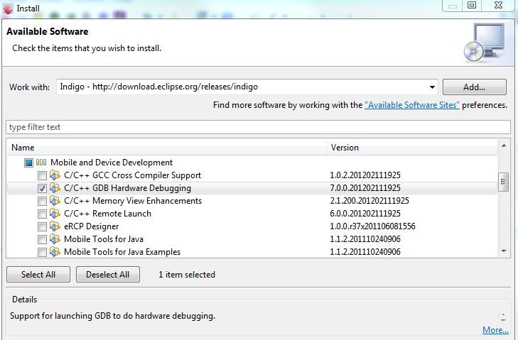

Step 2 Install gdb
Help--> install new software: Go to indigo update site and install GDB hardware plugin.

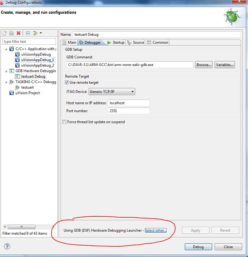

Step 5: Configure launcher.
Select Standard GDB Hardware Debuggin Launcher by pressing "select other" see previous picture.

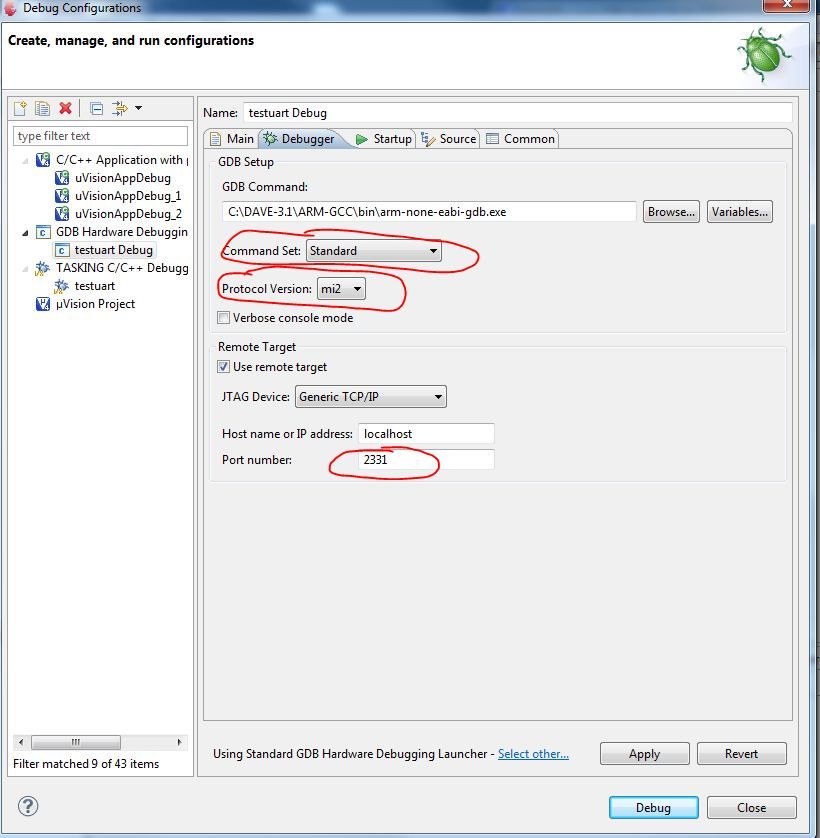

Step 6: Configure Debugger tab
Configure as shown in the below picture the debugger tab.

Step 2 Install gdb

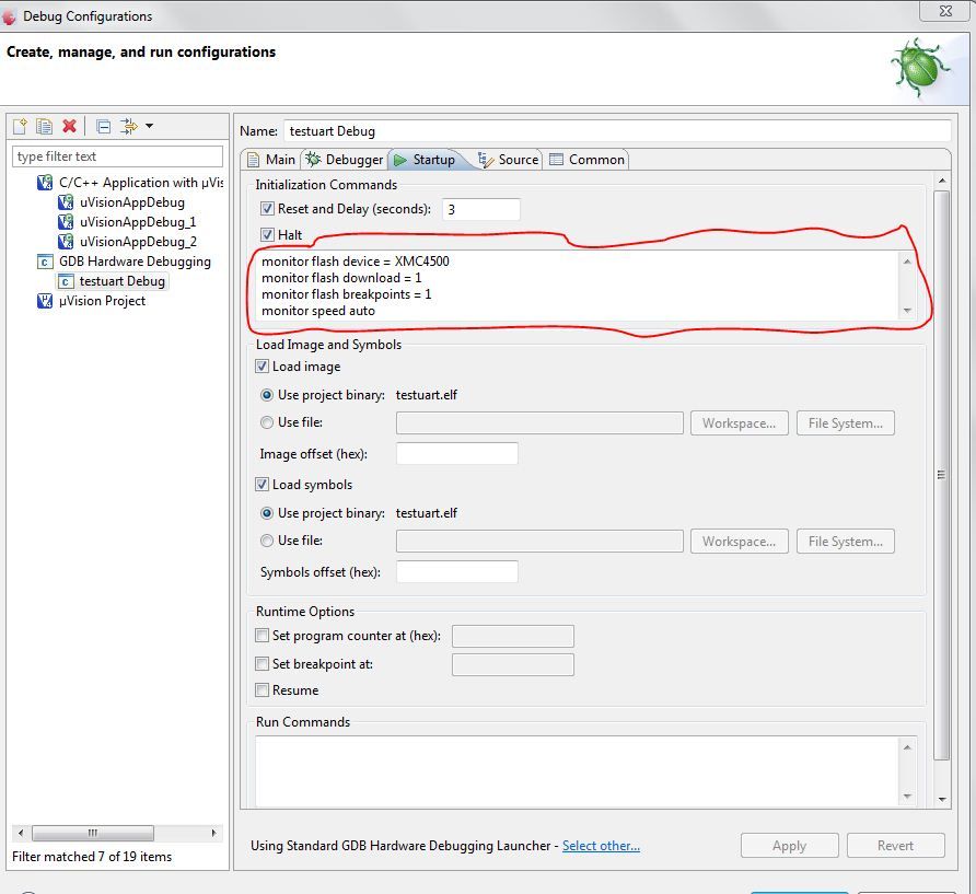

Continuing from the previous post.
Step 7: Configure the startup tab
Setting in text format for easy copy and paste:
Press debug and it enjoy.
monitor flash device = XMC4500
monitor flash download = 1
monitor flash breakpoints = 1
monitor speed auto

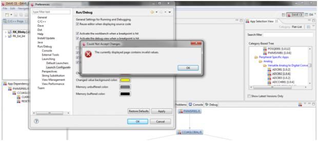

Hi Oreste,
I got problem when trying to follow the step,
I have no idea hoe to fix it.
Ali
Ali

AliAkbar wrote:
Hi Oreste,
Ali
Sorry too low resolution. Could you attach at full resolution ?

The problem is already fixed,
Just need to restart it 😄
thanks
