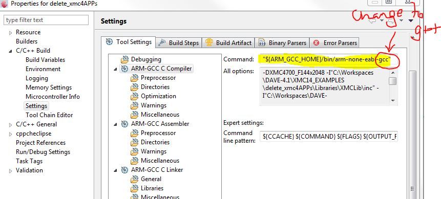

I already found these informations. But it is no help. Since I cannot configure a c++ compiler in DAVE 4.1.x. The toolchain only shows gcc and not g++.
Renaming the call to g++ from gcc is not a solution because one is missing all options to configure g++

It should be possible to compile using the C++ compiler by renaming at least one of your project files from .c to .cpp extension.
Another way is to change the project settings:
Goto:
Project -> Active Project Properties -> C/C++ Build -> Settings -> ARM -GCC C Compiler.
- Under Command: "${ARM_GCC_HOME}/bin/arm-none-eabi-gcc"
- Change arm-none-eabi-gcc to arm-none-eabi-g++

As i have written, renaming is no clever posibility, because the configs in eclipse are still expecting a gcc and not g++ and therefore the GUI config settings do not match.
Why is ARM-G++-Compiler (and linker) excluded in the ARM-GCC-Applikation toolchain of DAVE?
It is not problem to use g++ in eclipse with a proper setup toolchain.

Hi Holger,
Please replace the existing contents of ARM-GCC C++ Compiler "Command Line Pattern"
From:
${CCACHE} ${COMMAND} ${FLAGS} ${OUTPUT_FLAG} ${OUTPUT_PREFIX}${OUTPUT} ${INPUTS}
To:
${COMMAND} ${FLAGS} -MMD -MT ${OUTPUT_PREFIX}${OUTPUT} ${OUTPUT_FLAG} ${OUTPUT_PREFIX}${OUTPUT} ${INPUTS}

🙂 This is exactly what I have written in this post:
http://www.infineonforums.com/threads/3895-Solution-for-recompile-problem-in-c?p=11539&viewfull=1#po...
Well, nice to see that my solution is correct. I hope to see this in the next release.
