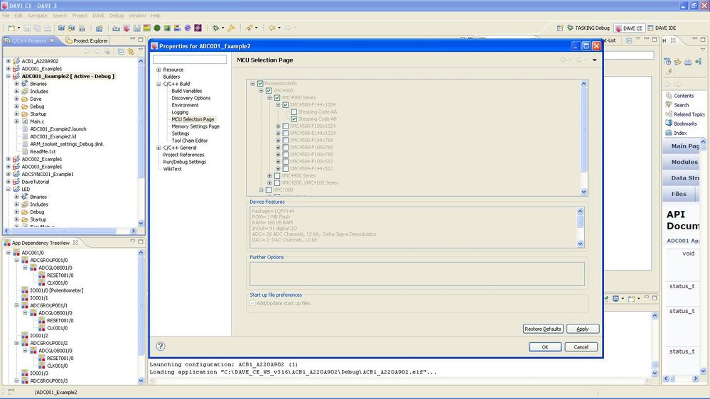

Ref my earlier post : ADC001_Example2 : "Error within DebugUI" when trying to run in debugger
I need to change the target MCU Stepping Code from AB to AA and vice versa. I can get to the MCU selction page but all the options are greyed out. Please see screen shot below.
Any help very much appreciated.
Aaron
Aaron

I asked this same question a yesterday http://www.infineonforums.com/threads/756-Updating-existing-Apps-within-a-project-the-latest-version
Short answer is that changing target is only supported on project creation.

Thanks very much Doug. I guess I'll have to transfer existing project code to a new project somehow as a workaround.

Is there a way to transfer the hardware design and code to a new project?

Hi danbeadle,
Have you installed DAVE v3.1.8? It can run parallel with DAVE v3.1.6. No uninstallation is required for the DAVE v3.1.6.
The "Device Migration" function is available in DAVE v3.1.8. Pls import your DAVE project from old DAVE v3.1.6 workspace to the new DAVE v3.1.8 workspace first then do "Device Migration".
Sophia
