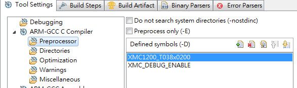

I would like to watch the XMC_DEBUG message in DAVE debug console.
I added a define "XMC_DEBUG_ENABLE" in preprocessor and enable semihosting in debug option.
But I don't see any debug message in my console.
Do I loss some setting for it?
Robin
