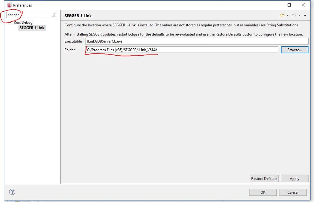

When trying to run a sample code for the 24v shield I keep getting the following
Error in services launch sequence
Launching command [/JLinkGDBServerCL.exe -if swd -device XMC1100-T038x0064 -endian little -speed auto -port 2331 -swoport 2332 -telnetport 2333 -vd -ir -localhostonly 1 -singlerun -strict -timeout 0] failed.
Cannot run program "/JLinkGDBServerCL.exe": Launching failed
When debugging it.
Following the steps for setup from this page
https://www.infineon.com/dgdl/Infineon-24V_ProtectedSwitchShield_with_Profet+24V_for_Arduino_UsersMa...
Any help would be greatly appreciated.

See if the correct path is set (newes J-Link Software)
best regards
Andreas H.
