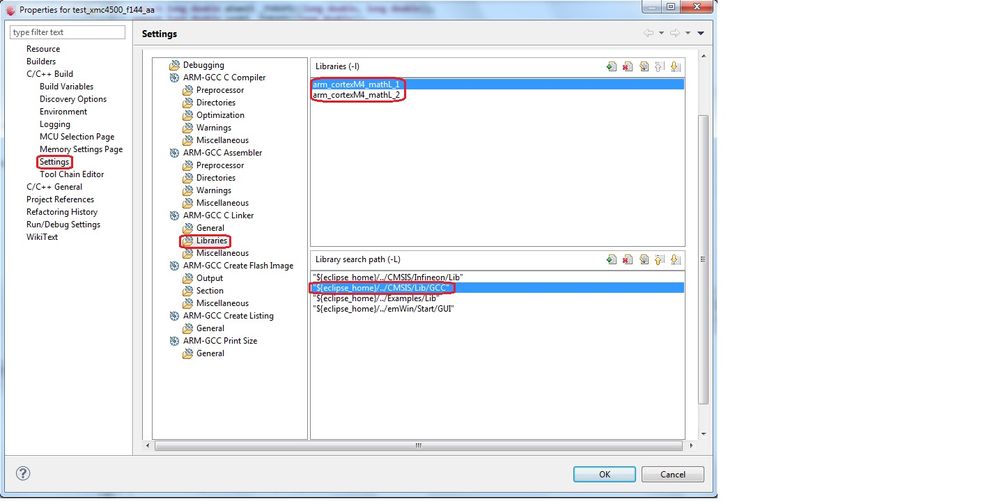

If the math function is from CMSIS DSP library, the math library is under C:\DAVE-3.1\CMSIS\Lib\GCC.
1) Go to Project -> Active Project Properties -> C/C++ Build -> Settings -> ARM-GCC C Compiler, add "__FPU_PRESENT" (when FPU is required) & "ARM_MATH_CM4" in the Preprocessor
2) Go to Project -> Active Project Properties -> C/C++ Build -> Settings -> ARM-GCC C Linker,
2a) Add "arm_cortexM4_mathL_1" & "arm_cortexM4_mathL_2" in the Libraries (-l)
2b) Add ""${eclipse_home}/../CMSIS/Lib/GCC"" in the Libraries search path (-L)
3) Add "#include" in main.c

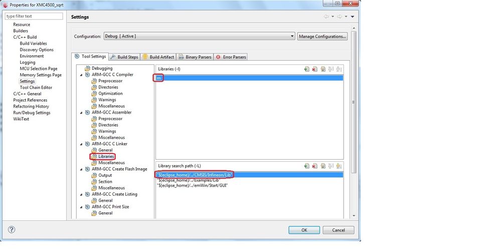

If the math function is from newlib library, the math library is under C:\DAVE-3.1\CMSIS\Infineon\Lib.
1) Go to Project -> Active Project Properties -> C/C++ Build -> Settings -> ARM-GCC C Linker, add "m" in the Libraries (-l)
2) Add "#include" in main.c
Refer to web-page (http://sourceware.org/newlib/libm.html) for the available math functions provided by newlib library.

DSP library update:
Pls take a note that the DSP libraries libarm_cortexM4_mathL_2.a & libarm_cortexM4_mathL_1.a can only be used in earlier DAVE versions (v3.1.6 or earlier).
Instead the libarm_cortexM4lf_math.a should be used for newer DAVE versions (v3.1.8 or later). They are located in the same folder (eg. C:\DAVE-3.1.10\CMSIS\Lib\GCC).
