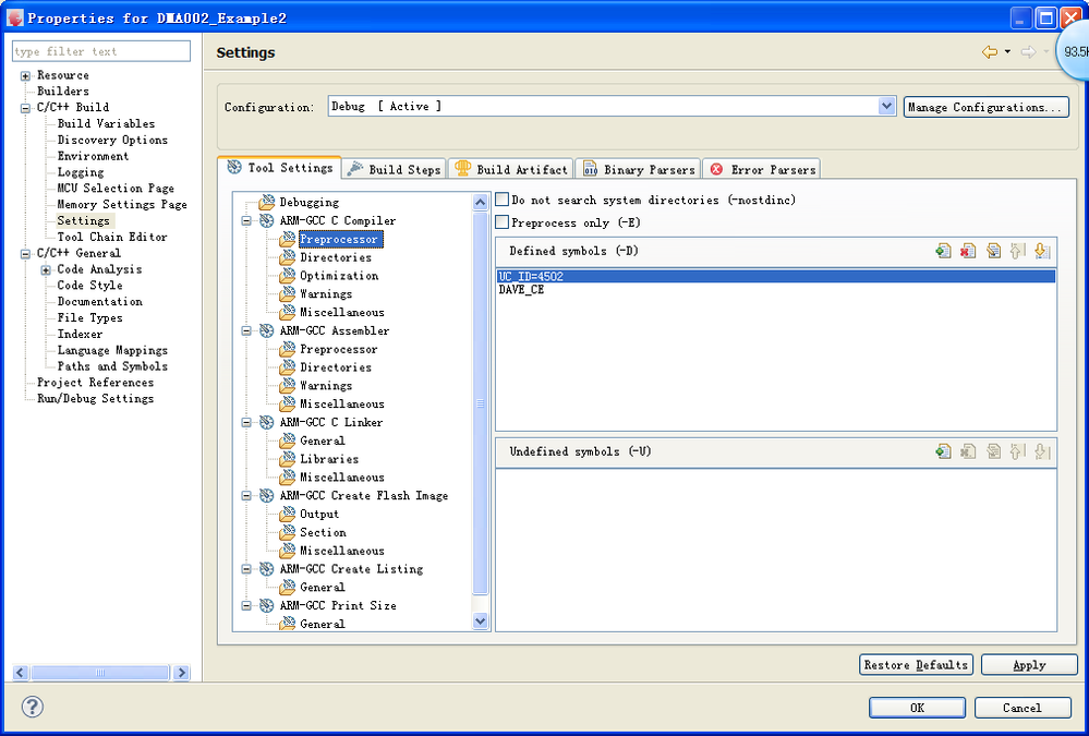

Hi wforest68,
check your settings at Project -> Properties and compare to the settings on the screenshots of my installation of Dave3.1.8.
Best Regards

Hi lng99,
My setting at Project -> Properties and compare to the settings on the screenshots is :
Thanks your reply
