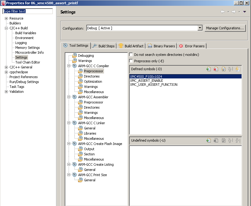

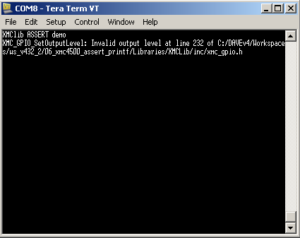

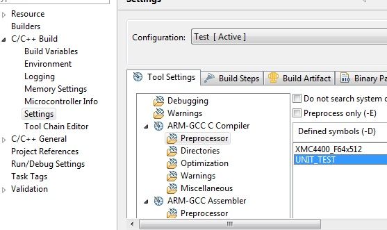

You are looking for setting preprocessor symbols.
Go to the Properties of your project and click on C/C++ Build>Settings>ARM-GCC C Compiler>Preprocessor.
On how to use the XMC_ASSERT have a look to the attached example included in XMClib examples/XMC4500_series/UART/UART_PRINTF

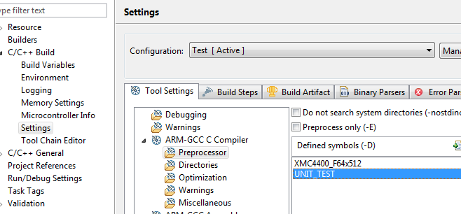

If i work in Debug-configuration and add a preprocessor-symbol "UNIT_TEST" ( in Properties of my project C/C++ Build>Settings>ARM-GCC C Compiler>Preprocessor)
the compiler knows the symbol if defined -> . #if defined(UNIT_TEST) is working
If i work in Release-configuration and add a preprocessor-symbol "UNIT_TEST" ( in Properties of my project C/C++ Build>Settings>ARM-GCC C Compiler>Preprocessor)
But, if i add a preprocessor-symbol "UNIT_TEST" only in Build-configuration Test ( and delete the symbol in config Debug and Release)
the compiler doesn't know the define: #if defined(UNIT_TEST) is not working
I set configuration Debug as active -> symbol UNIT_TEST unknown -> correct
I set configuration Release as active -> symbol UNIT_TEST unknown -> correct
I set configuration Test as active -> symbol UNIT_TEST unknown -> bug / failure !!! The code-block is greyed out -> see picture below

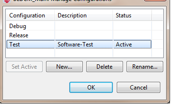

I used BuildConfiguration -> Set Active -> Test
and i used BuildConfiguration -> Manage: choose Test and -> Set Active
to switch between the 3 Build-Configurations.
Is this a Bug in Dave?
The code-block is greyed out:

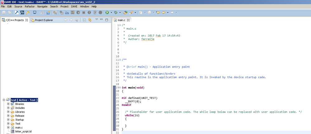

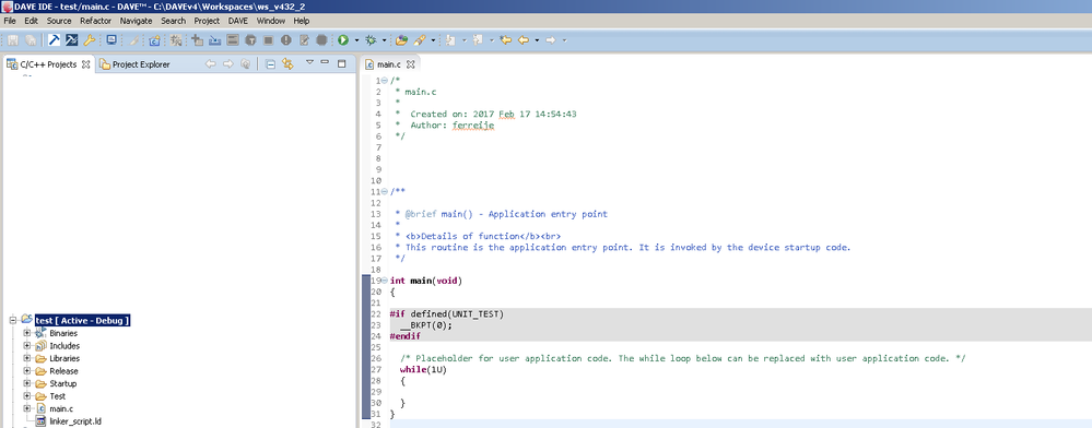

For me it is working. I created a third configuration, named Test, as a copy of the Debug one.
In the properties of the project, in the preprocessor macros I added UNIT_TEST.
For the Debug and Release configurations, the macro is not defined and therefore the code is grayed out.
For the Test configuration the macro is defined and therefore the code is not grayed out.

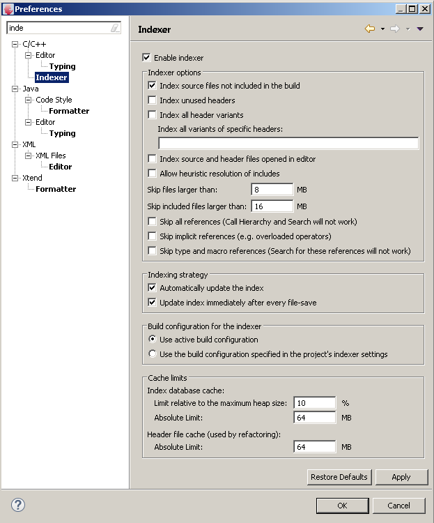

Please check the setting in the indexer
Sometime also helps to rebuild the index.

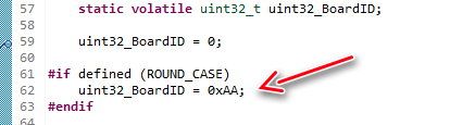

I have run into the exact same problem today, I have a new build configuration where I have added the macro ROUND_CASE.
It all seems fine when looking at the IDE, the section of code that is dependent on that macro to be defined is greyed out when I am NOT in my new build configuration. When I am in my new build configuration then the code is enabled and it all "looks" good.
The problem is that the actual code does not get executed at run time.
I reach my breakpoint at line 59 and then step through the code but line 62 is never executed, it just goes straight into line 65 (not seen in the snippet, no need for that). My test variable in the code is never assigned the 0xAA value.
Can someone please try this with an actual target and step through the code to see if it works at run time?
Thanks in advance.
-Howard
Thanks in advance.
-Howard

Never mind, this works just fine, turns out I made a mistake when creating my new build configuration (I did not copy the settings from the Debug version so the debugger was not happy).
Thanks to my local Infineon's FAE, he came to the rescue fairly quickly.
