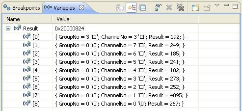

Thank you Georg, my mistake. I found the “ Delete project contents on disk (cannot be undone)” option. I have attached a picture of the dialog.
Aaron
Aaron
