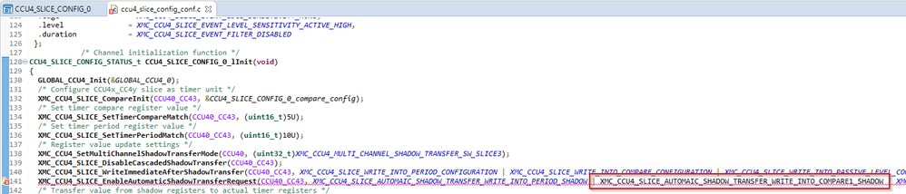

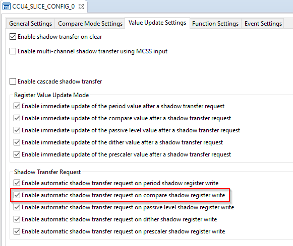

there is an BUG in generating the source files for this app:
4856.attach
4857.attach

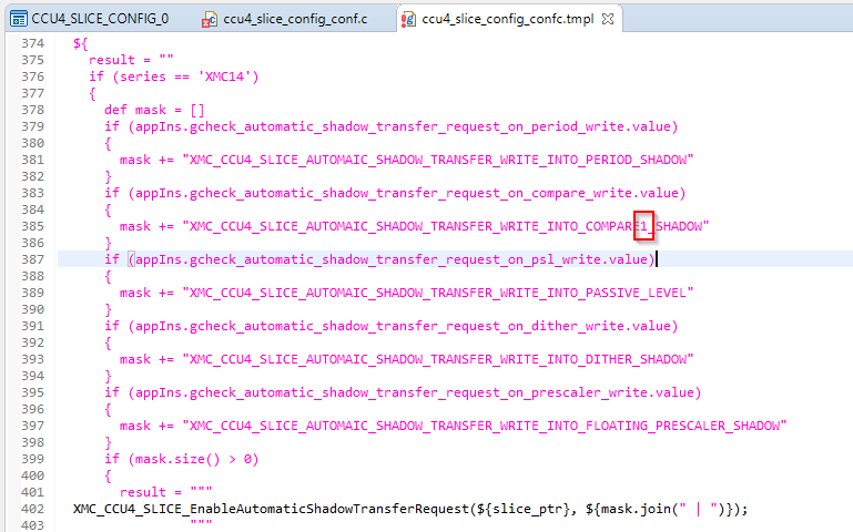

the template file are wrong:
4858.attach

Thanks for the feedback. It has been fixed and it will be released in the next days
