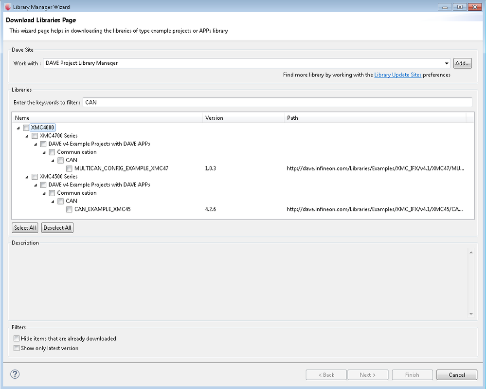

You can start looking to the CAN_NODE APP and examples

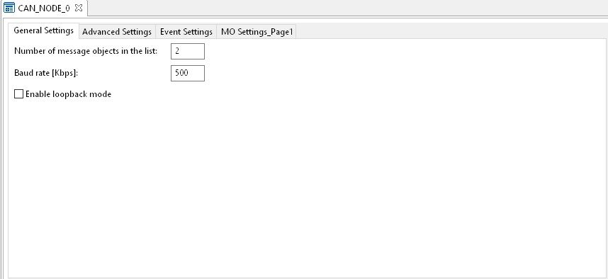

For anyone looking to implement basic CAN, here are the steps for building and transmitting two CAN messages each containing 8 bytes of data (without error handling)…
1) ADD the 'CAN_NODE' App to your project using DAVE's 'Add New APP' feature

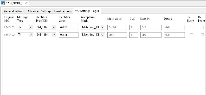

2) Configure the APP. In this example I have specified 2 message objects with a transmission rate of 500kbps. The messages have CAN ID's of 0x130 and 0x131. Each message object (MO) contains 8 data bytes to be transmitted (64 bits of data).
3) To transmit a message object containing your data, you need to write your 64 bits of data into the two 32 bit registers (Data_H and Data_L) of a message object before initiating a CAN message transmission.
It is entirely up to you and the receiver what you put in the 8 bytes. For example two of the bytes might contain 16 independent flags, a 32 bit value spread over 4 consecutive bytes and two 8 bit values in two independent bytes.
The data format is normally specified in a '.dbc' data base file. There are many free viewers for such files enabling you to agree the format with the receiver.
