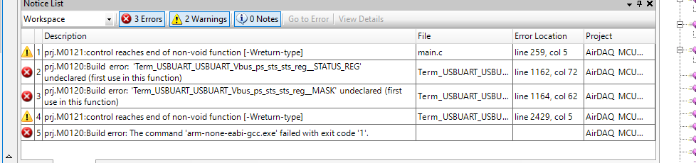

Hi Len,
I have defined 2 UART interfaces in my project [UART via RS232 connector or USBUART via USB connector, not simultaneously]
I am trying to define that the code will be able to identify if the user is using the USB connector or the RS232 connector.
In order to do so, I have though [with the support of MoTa_728816] to use the VBusPresent as indication.
Unfortunately I need to modify manually the "Term_USBUART_USBUART.h" from "0u" to "1u" before building:
#define Term_USBUART_USBUART_MON_VBUS               (1u)
and I am receiving these errors when I try to build:
Please your support so I can use the VBusPresent in the Term component.
Roy Roif
RoRo_4659551
Level 4
25 replies posted 10 replies posted 10 likes given
Level 4
I have solved this issue using a different method with the great support of MoTa_728816​.
Thanks anyways Len

Level 9
Dear Len-san,
While I was helping Roy-san last night, we found a few points that your Terminal library can be improved.
Although this can be redundant explanation, let me write what the Roy-san's use case.
- His system uses two Terminal Lib instances, one for UART and the other for USBUART.
- But only 1 of the Terminal Lib is supposed to be used, depending on the hardware connection at startup.
     If USB cable is connected, use USBUART, or if UART connection is available use UART.
     Note: as it seemed to be difficult to check if UART is connected, we tried to decide this by checking USBUART condition.
At first we were bewildered how to figure out if the USB connection is available.
So we thought that we can use USBUART_VBusPresent() function,
but it requires the USBUART_VBUS_MONITORING_ENABLE is set.
To set this, we need to access the advanced tab in the USBFS component configuration dialog.
But we could not find a way to access the configuration dialog of USBFS (USBUART) from Term component.
Improvement Request (1)
It would be nice, if we can open the component dialog of USBFS from the Term component.
Then Roy-san found that there is another usable function USBUART_IsTxReady(),
which can be used without changing the internal component's bits.
So we could solve the first problem we encountered.
After (we thought that) we could switch between Term_UART and Term_USBUART,
the project build failed, because of multiple definition of internal variable of Terminal Library,
the variable name seemed to start with ifc or itc something.
Improvement Request (2)
It would be nice, if we can have multiple instances of Term component.
So we changed one Term component to mare UART component.
The project could be built, and at first everything seems to be OK,
but Roy-san found that when using USBUART, getchar() is not working anymore.
Note: This one was the toughest one of last night.
After an hour or so, by seeing the register names,
I came up with an idea that the instance name Term_USBUART may be too long.
So I asked Roy-san to change the name from Term_USBUART to Term.
Then getchar() resumed to work again.
Improvement Request (3)
It would be nice, if the Terminal Lib can generate waring or error when the instance name is too long
or support longer name.

Motoo-san,
I have detected multiple issues with more than one instance of Term.   I have corrected one of the issues and I can get multiple instances of Term working independently.
The other issues for more featured operation require a bit more thought, coding and debugging.
I have questions regarding your Improvement Requests
Can you be more specific about this part of the request?
Is USBUART_IsTxReady() solution sufficient?  Note:  There is no practical equivalent for UART functionality other than if the FIFO is full or not.
The issue is naming uniqueness of these auxiliary components.  Oops!  A future fix is to make these components into components with shared library instances.  A bit more work to get it there.
Working on that.   Hopefully there will be a fix soon.
Interesting.  I've confirmed this is an issue.   I don't think it is because of the long names.   C can parse and operate with very long variable names.  Hmm.  I'll get back to you with an answer.
If issue highlighted in Improvement Request (3) is due to too long of instance name, I'll try to create a pre-compiler warning.
Motoo-san and Roy,
Thank you for using Term and I appreciate the feedback to make this a more useful component.
If either of you has created a component, you can appreciate that it can get complex quickly.   This is especially true when trying to make it work with multiple instances.  Bravo to Cypress for creating a great substructure of Creator to help designers minimize complex reusable code generation.
Len

Motoo-san,
So we wanted to check if the USB connector is connected, which means the project will use USBUART,
at first I was thinking of timeout, but we found a function "USBUART_VBusPresent()" which seems to be able to tell us if VBus is present.
But this function is not enabled unless we check VBUS Monitoring option in the USBUART Configure Dialog > Advanced tab.
And we could not find a way to call up this Dialog from Term Configuration Dialog.
So I wished if there were a way to invoke this dialog from Term Component Configuration Dialog.
If the "USBUART_VBusPresent()" function reports the status of VBus without initializing USBUART,
it would be preferable.
But for the time being, I hope that Roy-san can survive with USBUART_IsTxRead() function.
Let me update the Term 2.2 to 2.3 as a quick release to address most of the issues you and Roy pointed out.  I believe I can pass through the Advance tabs options.  However, you will notice that they are not implemented as Cypress customizer code using C#.  I wouldn't mind calling customizer C# code as a pass-through if you know how to do that.  For now, all configurable parameters will have to be implemented by Tabs with field-adjustable parameters.
There are additional improvements I'd like to add.  I can save it for another future version.
Agreed. But the generated internal Register names were very long.
Meantime, as Roy-san named the component "Term_USBUART", it might have affected the naming scheme of
Term component or USBUART component.
Anyway, I'm very interested in the real reason of this problem.
One thing I'd like to mention again is that, even with that name "Term_USBUART", PutString() was working OK.
Since GetChar() was not working, we could not confirm about PutChar() though.
I found the solution as listed in the post below.  In summary:
change cyapicallbacks.h from:
#include <Term_cyapicallbacks.h>
to match the new Term instance name:
#include <Term_USBUART_cyapicallbacks.h>
Len
Len
"Engineering is an Art. The Art of Compromise."
I reproduced the issue.  I renamed my Term component (as USBUART) to Term_USBUART.  Same results as you received.
The issue is that when you rename the Term component, you also need to change the line in the cyapicallbacks.h from:
Once this was changed, the _GetChar() function works again.
I did notice a strange issue.  A "Clean" of the project or a "Generate Build" does not remove the old Term_cyapicallbacks.h from the Generated_Source directory.  Hmm.  A Creator 'bug'?
