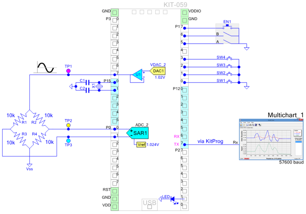

Figures 2. Example of schematic created using Annotation Library and KIT-059 stub.
