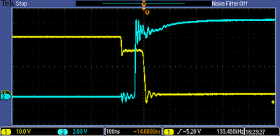

I have developed a custom PCB using the IRS2452AM Class D audio amplifier control IC and came across an issue I need help with. For my specific problem I need to switch at a minimum of 500kHz (although I have seen this same issue no matter what switching frequency I use) and I noticed that at idle (Zero Volt Switching "ZVS") I was developing a DC bias on my output. I tracked this back to an uneven duty cycle between the positive and negative halves of the bridge. Looking into it further I realized that my high side FETs are not turning off when they should and are staying on too long. There is even SHOOT THROUGH during every transition. Initially I thought the issue was just on my PCB, however after getting out the IRAUDAMP23 I have found the same issue there.
It looks like there is a delay between when the IC is trying to pull down the drive signal (HO1 and HO2) and the FET actually turning off. This delay is constant no matter the frequency, but with higher switching frequencies it becomes more apparent and results in the uneven switching I am seeing.
Since I am switching at a high rate I implemented the optional gate driver circuits laid out in AN_1811_PL88_1811_234119 "IRS2452AM Class D Amplifier IC Functional Description" and also used in the IRAUDAMP23 Development kit datasheet (of which I have one)
The scope screen grabs below are pulled from the IRAUDAMP23 dev board.
This first image is of the HO1 signal attempting to drive the high side FET. Notice the stair step on the turn ON and the delay in the turn off.
This second image is of the turn OFF for HO1 (Yellow) and the turn on for LO1 (Blue). Notice that if HO1 had turned off when it first tried to there would have been ~40ns of deadtime which matches my settings. Instead there is about 40ns of Shoot Through!
Here there is the turn off for the Gate on the High Side FET (BLUE) and the turn on for the low side FET (Yellow). Note Shoot Through causing the gate on the Low side FET (Yellow) To be sagged down significantly.
Is this a known issue with high side of the gate drive circuit called out in the app note or an issue with the IC?
I would really like to not have shoot through.
