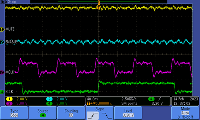

I have captured some of the signals on my scope:
Full Power-up Sequence:
There is a blip on the MCLK line when the output pin is first muxed to output the clock, a 24MHz signal is briefly present.
Clock Blip Detail
Enable Detail. MCLK is 12.288MHz at this point:
There is a 6-7 ns phase shift between MCLK edge and the BLCK edge, probably due to propagation through the SAI peripheral.
During Playback:

I do not know what else to check as there are no errors being reported as far as I can tell.
Is the clock blip before the amp is enabled a problem?
Is the phase shift between the MCLK and the BCLK a problem?
Any thoughts on next steps in debugging this issue are appreciated.

The problem of audio output might come form the fact the MSEL0 pin requires 5V instead of 3.3V :

Thankyou for your reply, we are planning to use the MA12070P for this design in our next board spin. I will pass this recommendation along to the hardware team.
I will test with MSEL 0 connected to 5V and let you know if that resolves the issue.

After cutting the MSEL0 connection to 3.3V and connecting it to 5V I am now getting some output from the amp. There is still an issue somewhere as the output is not as expected, but it is probably a software issue that I must debug.
