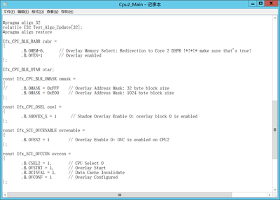

Just modified a overlay demo for TC397. It's compiled and read 32 bytes from flash, the LMU 0xB00A0000 is mirrored into the target address Test_Map_Cal_Flash[32], it works.

In my posted example, when you access Test_Map_Cal_Flash[32] in Pflash, you do access LMU in fact. Test_Map_Cal_Flash[32] is in located into 0x8.

I took a look at your project,overlay driver config with LMU and only core2.in my project,i use target address segment 0x8 , overlay memory  is DSPR,but core1 overlay cant work properly? so could you please give me a project with enable overlay in core0,core1 and core 2 ?
