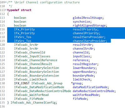

Hi Ivano,
The interrupt priority is in above funtion.    Below is the struct of ADC channel config.
typedef struct
    boolean                           globalResultUsage;              /**< \brief Specifies storage in global result register */
    boolean                           synchonize;                     /**< \brief Specifies synchronized conversion channel */
    boolean                           rightAlignedStorage;            /**< \brief Specifies result is right aligned */
    Ifx_Priority                      resultPriority;                 /**< \brief Interrupt priority of the result trigger interrupt, if 0 the interrupt is disable */
    Ifx_Priority                      channelPriority;                /**< \brief Interrupt priority of the channel trigger interrupt, if 0 the interrupt is disable */
    IfxSrc_Tos                        resultServProvider;             /**< \brief Interrupt service provider for the result trigger interrupt */
    IfxSrc_Tos                        channelServProvider;            /**< \brief Interrupt service provider for the channel trigger interrupt */
    IfxEvadc_SrcNr                    resultSrcNr;                    /**< \brief Service node of the result trigger */
    IfxEvadc_SrcNr                    channelSrcNr;                   /**< \brief Service node of the channel trigger */
    IfxEvadc_ChannelId                channelId;                      /**< \brief Specifies the channel index */
    IfxEvadc_InputClasses             inputClass;                     /**< \brief Specifies input class selection */
    IfxEvadc_ChannelReference         reference;                      /**< \brief Specifies Reference selection */
    IfxEvadc_ChannelResult            resultRegister;                 /**< \brief Specifies Result register selection */
    IfxEvadc_BoundarySelection        lowerBoundary;                  /**< \brief Specifies lower boundary selection */
    IfxEvadc_BoundarySelection        upperBoundary;                  /**< \brief Specifies upper boundary selection */
    IfxEvadc_BoundaryExtension        boundaryMode;                   /**< \brief Specifies Standard mode of fast compare mode */
    IfxEvadc_LimitCheck               limitCheck;                     /**< \brief Specifies boundary band selection upper/lower */
    IFX_CONST IfxEvadc_Adc_Group     *group;                          /**< \brief Specifies pointer to the IfxEvadc_Adc_Group group handle */
    IfxEvadc_DataModificationMode     dataModificationMode;           /**< \brief Specifies the Data Modification Mode.According to the value entered here, the meanings of values entered for dataReductionControlMode will mean either the number of results accumulated(GxRCRy.B.DMM=0) or filter coefficients(GxRCRy.B.DMM=1). */
    IfxEvadc_DataReductionControlMode dataReductionControlMode;       /**< \brief Depending on the valued of dataModificationMode, the meanings of values in this will differ.For details refer definition of IfxEvadc_DataReductionControlMode enum in IfxEvadc.h */
    IfxEvadc_WaitForRead              waitForReadMode;
    IfxEvadc_FifoMode                 fifoMode;
} IfxEvadc_Adc_ChannelConfig;

It is not possible. as already said before, the "config" structure (type: "IfxEvadc_Adc_FastCompareChannelConfig") does not contain the "resultPriority" element.
the only elements of the structure are:
typedef struct
    IfxEvadc_Adc                                       *module;
    IfxEvadc_GroupId                                    fastCompareChannelId;
    IfxEvadc_BoundaryFlagActivationMode                 boundaryFlagActivation;
    IfxEvadc_BoundaryFlagInversionControl               boundaryFlagInversion;
    IfxEvadc_BoundaryFlagNodePointer                    boundaryFlagNodePointer;

Hi Ivano,
I have noticed the config has no this member, have you tried add resultServProvider and resultPriority into config's struct?

how can you think that by adding members to a structure everything starts to work magically? I have no time to waste making absurd tests.

Hi Ivano,
Because below call is to enable the interrupt service...
IfxSrc_init(&SRC_VADCFC2SR0, IfxSrc_Tos_cpu0, ISR_PRIORITY_ADC);
IfxSrc_enable(&SRC_VADCFC2SR0);
