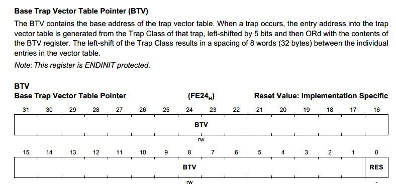

Hi
for interrupts, u can change the Base Interrupt Vector Table Pointer (BIV) content.
for traps, u can change the Base Trap Vector Table Pointer (BTV) content.
these are normally initialized in the startup code together with the compiler/linker files.
